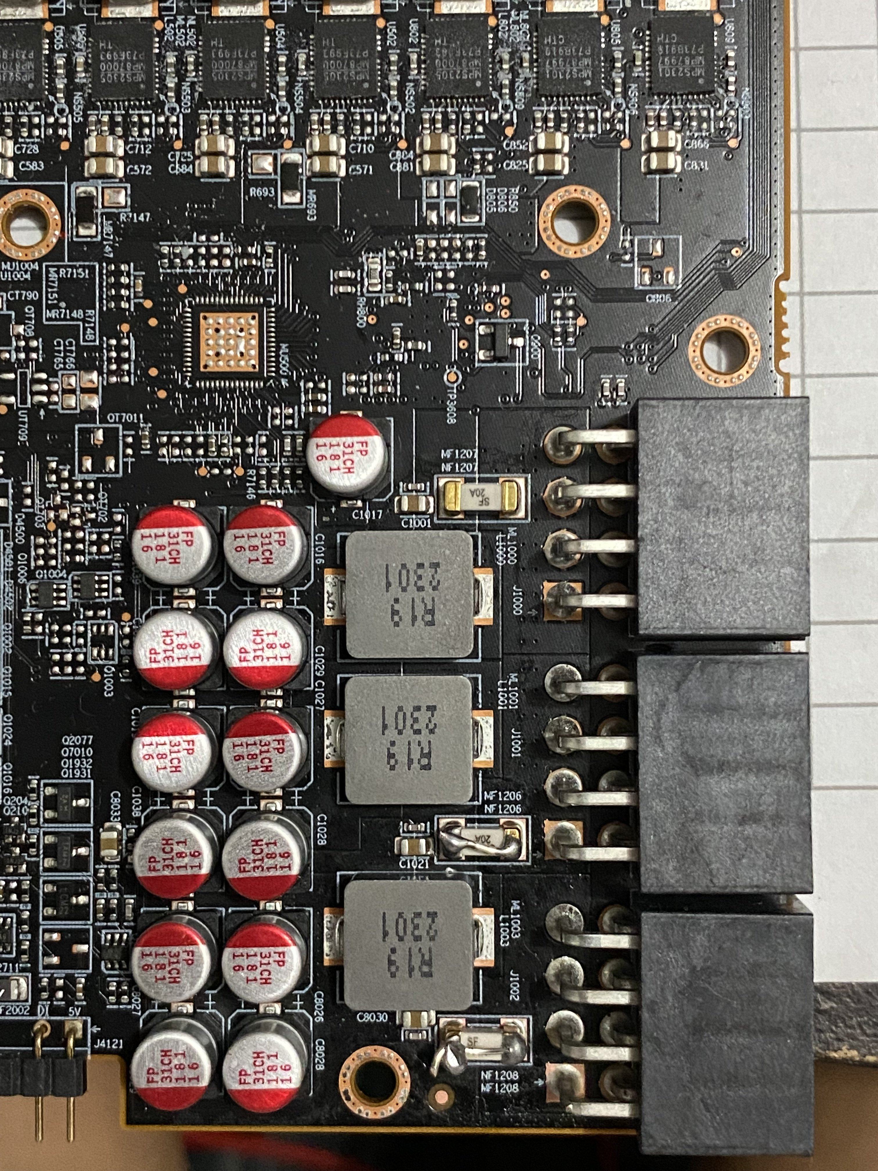

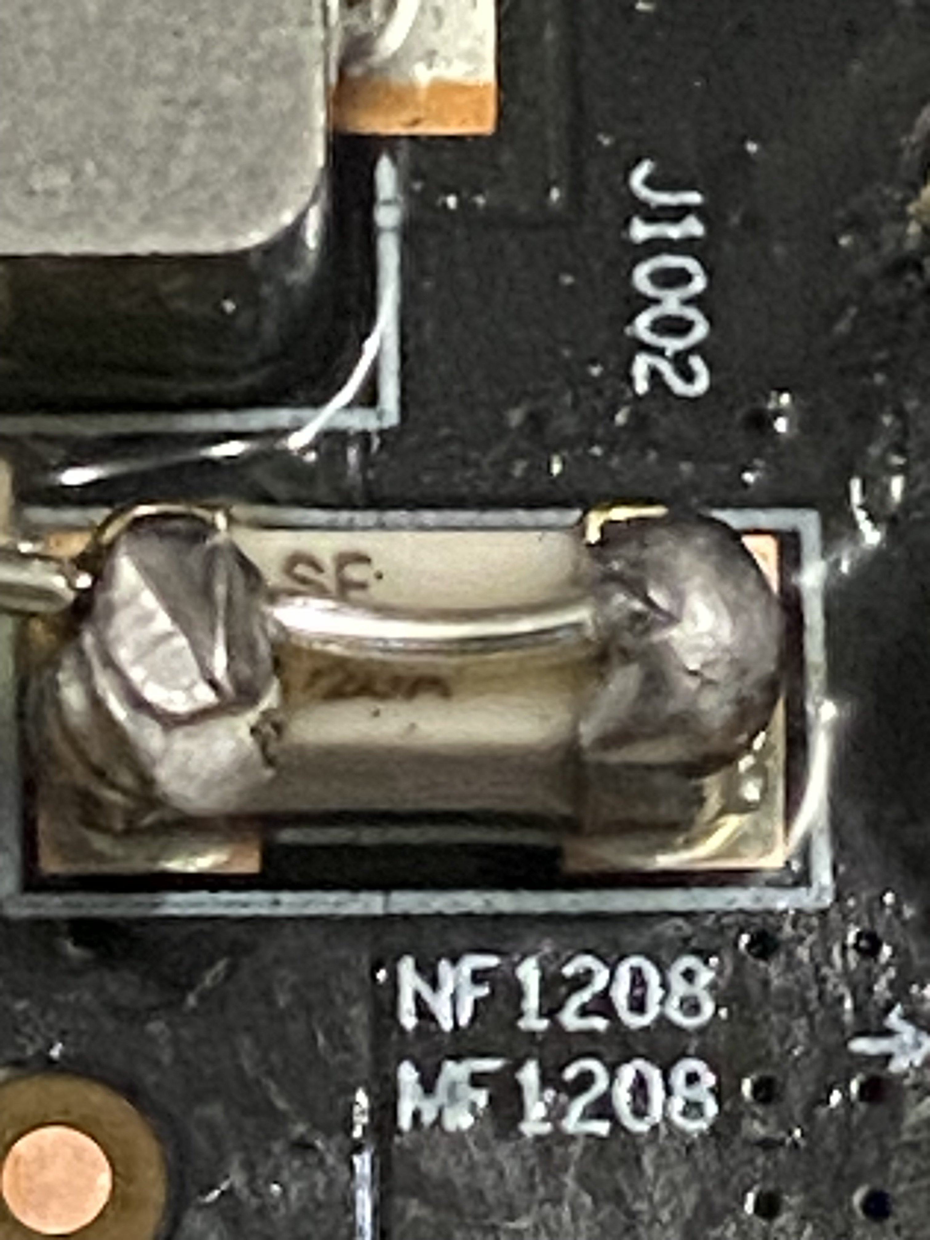

My Nitro+ died, fuse blew up under TSE due to too much voltage so I had to do this.:d Same thing happened with my 6800 XT Nitro+.
Anhang anzeigen 894234Anhang anzeigen 894235
Exactly the reason I didn't buy a Nitro. :lol:
These are 20A fuses. So in total 720W is allowed to flow before they blow up and when you increase the voltage and set the gain very high you are pulling more power from the power supply than these poor fuses can handle. :ROFLMAO:
If I would have bought a Nitro I would have taken these all out and replace them with something like 30A fuses or with just a thick piece of wire like you did now. :d
Holzmanns 6900 XTXH Toxic EE gehört auch in diese Reihe.

Sehr interessant. (y) Wie sieht es bei den Customs der anderen Hersteller aus? Haben die ebenfalls Sicherungen, welcher Stärke und viele? @Techlogis gute Liste gibt dazu nichts her.
Gibt es irgendwo eine Sammlung hochauflösender PCB-Bilder? Mal bei TPU schauen ...

And Holzmann's 6900 XTXH Toxic EE also belongs in this series.
Very interesting. (y)What about the Customs of the other manufacturers? Do they also have fuses, what strength and how many? @Techlogi's good list doesn't say anything about it.
Is there a collection of high resolution PCB images somewhere? Let's have a look at TPU...
Thanks, mate! :d As far as I know, Asrock doesn't use fuses. I should have gotten the Taichi.
@ShirKhan About waterblocks, I'm using the Bykski. Temps are good. You just need to be aware of how to install it properly because the manual is useless and has errors.
After "fixing" the fuses, I noticed I had a hotspot problem -- hotspot was higher than usual and my mem junction was reaching 80C under load. I had to repaste and found that one of the VRAM thermal pads had been dislodged.

Die Sicherungen habe ich bis jetzt nur bei Sapphire gesehen.
Vor ich ein karte kaufe versuche ich review zu finden mit teardown bilder und schaue ich mich die an.
Ich lese auch genau wie viel VRM stages bestimmte Karten haben und wenn möglich auch schaue ich wie viele Kondensatoren sind bestückt.
All PCB sind seher ähnlich zu reference karte aber zum Beispiel Sapphire und Asrock haben mehr VRM stages und Kondensatoren.
Sapphire sieht bei Bilder haben mehr Kondensatoren bestückt. AsRock Taichi und Aqua haben einige pads frei gelassen. Kann sein das Asrock höhere Werte von Kondensatoren nimmt und dann lasst ein paar pads frei. Mindestens das ist der Fall mit Elko Kondensatoren neben denn Stecker. Kann man schon im Bilder sehen das Asrock 270u statt 180u nehmen aber dafür lassen dann ein paar pads leer.
So weit ich gesehen habe scheint so aus Nitro und Taichi/Aqua sind besten wenn an VRM und bestückte Kondensatoren geht. Aber ich könnte falsch liegen weil ich mich nicht alle Karten geschaut habe.

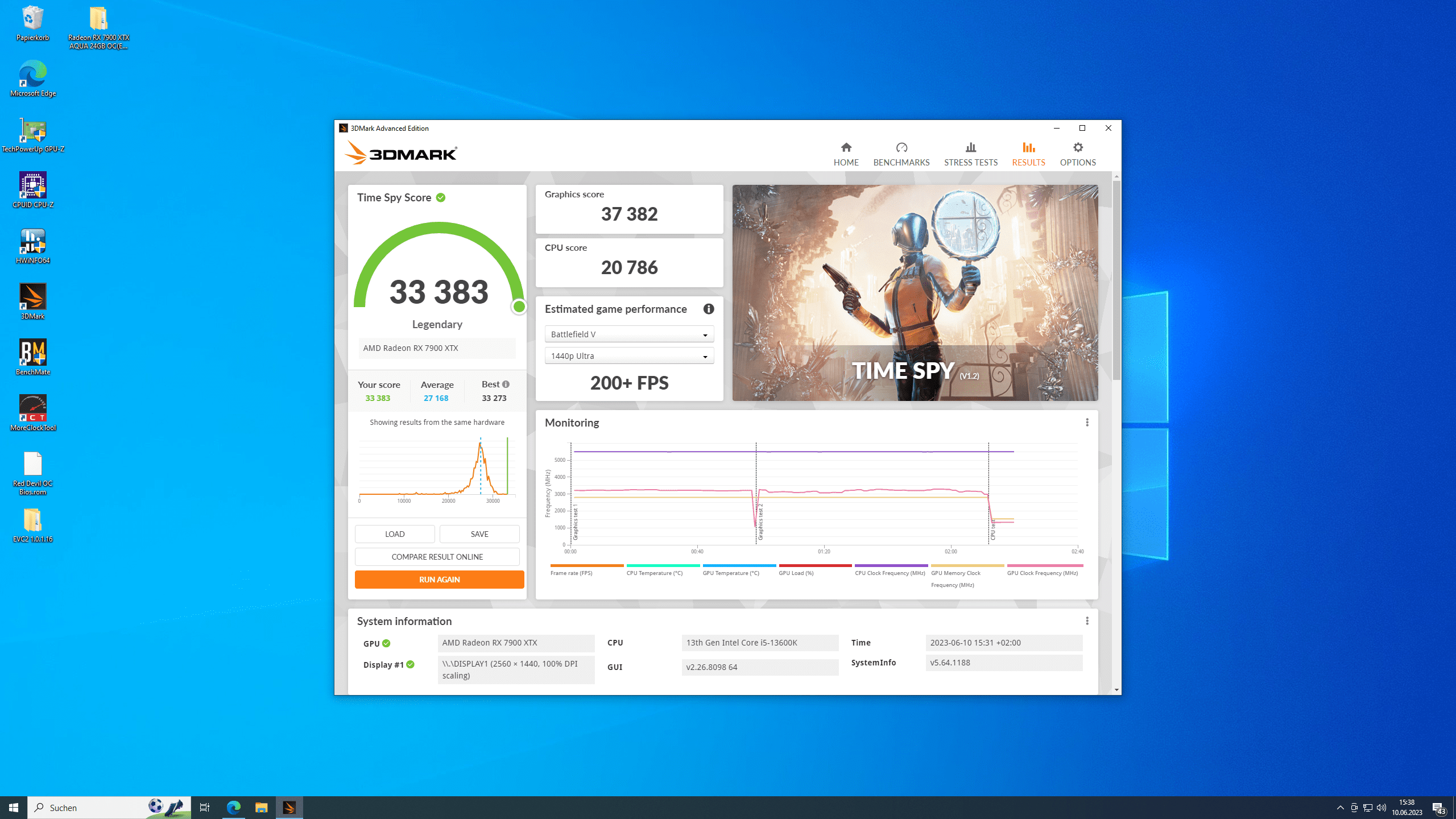

Ist ohne EVC, hatte gestern mal kurz mit ausprobiert, aber Punkte wurden weniger :unsure: Da muss ich noch mal schauen was da los ist.
Mit EVC gestern auch direkt den Klassiker, einfach mitten im Lauf PC aus :asthanos: 2. NT angeschlossen dann gings :haha:

Über 37k ohne EVC ist nicht schlecht. :-)
Ist das normale Aqua bios oder Extreme?
Ohne EVC habe ich so was mit Extreme bios gehabt.
Ja mit Extreme bios habe ich ähnliches score gehabt.
Mal schauen wie hoch kannst du unter Extreme mit EVC gehen.
Bei mir war 3400MHz Radeon setting schloss. Höher wollte meine karte nicht und gab crashes in TS.
Mit Normale bios kann ich 3500MHz im Radeon einstellen und boostet die karte bis ca 3450MHz in TS.
Einge versuche die ich gemacht habe höher zu gehen mit EVC hat mit Treiber crash beendet und Treiber hat nicht mehr mit DDU reparieren lassen. Ich muss Windows aus dem backup holen. :rofl:
