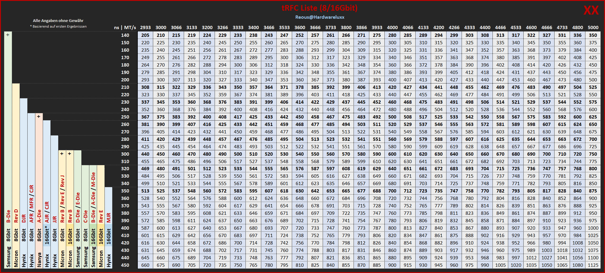

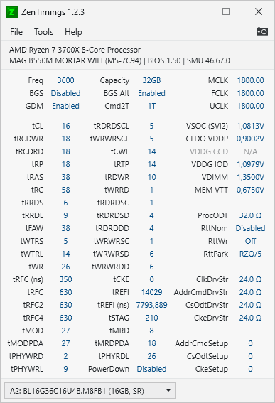

Recommended Safe TRFC? My board defaulted to 991 pushing latency to 75-77ns... Currently at 630 (350ns) TRFC like my previous 2x8 Samsung B-die kit. I assume this is due to the IC set being 16GB instead of 8GB?
Edit: just read a doctoral stating normal TRFC for 16GB sticks should be 480ns (864), and 640ns for 32GB. Same document also states 350ns for 8GB which makes sense.
Based on this, I can understand why Samsung B-die are popular since it can run at latencies closer to a 4GB IC.
Based on oc results 290/300ns is possible. 350ns is auto value
Thanks!
Was just little confused why 991 (550ns) is the default for my board. I'll just assume MSI hasn't tested/optimized Micron B-Die 16GB yet. (Auto should be 480ns or 450ns due to density? There's conflicting scientific papers/calculation on internet)
Would also mean "300ns" is quite decent relative to having a higher density IC vs 8GB SR
Edit: Apparently 550ns is "default" for alternative brands like SK HYNIX. They have "optional" 450/350ns modes. The data sheet for Micron Rev B claims 350ns default. Odd.
Edit 2:

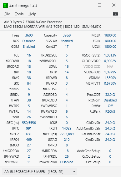

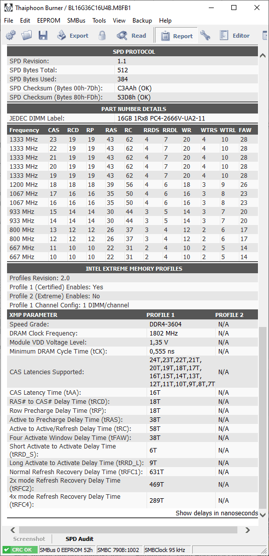

Okay I see what happened. My MSI board is forcing "3600" exact and its messing up the default TRFC for the profile.
The XMP profile is correct.. These are 350ns native sticks.. not bad for 16GB density.
Leaving mine manually set to 630/468/288 which is the correct value on this board. Pretty happy now... I'll likely OC later.

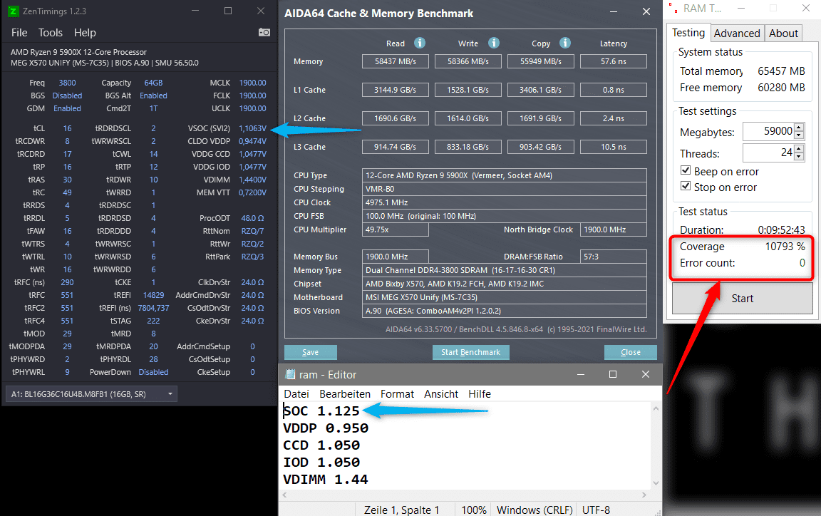

Update: aufgestockt von 32 auf 64 GB (4 x 16GB M8FB1 B-Die Single)
EDIT: SOC 1.100, VDDP 0.900, CCD 1.000, IOD 1.000, VDIMM 1.420 geht auch (Karhu getestet)

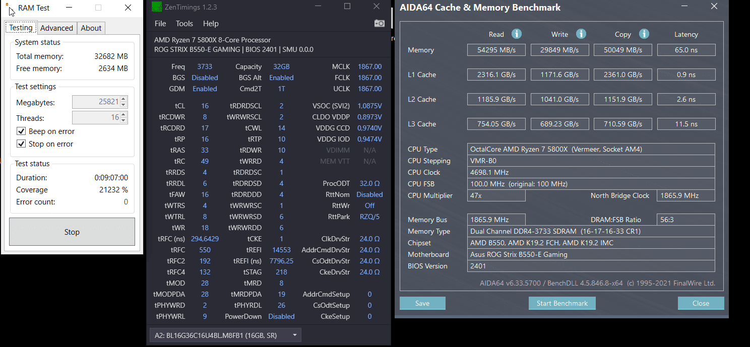

Ich bin endlich fertig mit testen und ich denke das Ergebnis kann sich sehen lassen, oder was meint ihr? Mit dem tRTP bin ich nicht zufrieden, aber auf 12 gibt es sofort Fehler im HCI und mit noch tieferen Werten bootet das Board nicht mal mehr, dafür sind die wichtigen Timings nun nochmal deutlich straffer geworden und die Spannungen sind auch schön niedrig. Karthu werde ich ggf. noch nachholen, bis dahin muss es HCI richten, da es sonst keinerlei Probleme gibt (keine zufälligen Reboots mehr, Spiele laufen stabil) hab ich es denke ich. Tipps natürlich immer willkommen, darf auch gerne vorne angepinnt werden. Als nächstes steht nun noch das neuste BIOS F60f vor der Tür, ich hoffe die Timings müssen nicht nochmal angepasst werden...

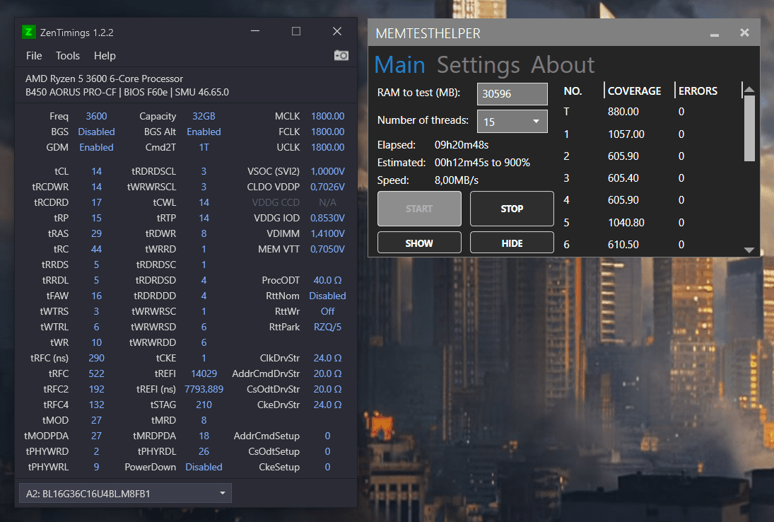

Habe nun alle Werte nach und nach einzeln durch getestet, jedesmal mind. bis 800% von vorne nach hinten, war eigentlich bereits fertig aber hatte immer nur bis 300-400% getestet und da kamen die Fehler nicht, so hab ich dann nochmal fast von vorne angefangen, aber hat sich gelohnt.
Hallo zusammen,
ich habe mit dem Update auf das finale F60 BIOS nochmal ein wenig mehr getestet, vorallem TestMem5 mit den anta777 Extreme1 Settings, das gab dann mit den Timings oben Fehler, was nur an zu niedrigen tRAS, tRC und tRFC Werten lag, darum habe ich diese nochmal etwas angehoben bis alle Fehler weg waren. Hier also nochmal ein weitere Screenshot, AIDA hab ich leider vergessen zu testen und das System geht nun in den Verkauf, da ich auf ein X470 mit R7 3800X und Samsung B-Dies umgestiegen bin im Hauptsystem. Wollte hier aber nochmal die Ergebnisse posten:

If youre on MSI, i would use 630 since the board forces 3600. XMP profile is 1802 = 631
So, habe nun mal das XMP richtig im BIOS eingetragen und bin so schonmal 2 ns schneller geworden.
Jetzt haben sich die Werte
tPHYWRL von 11 auf 9
tCWL von 14 auf 16
tRDWR von 8 auf 10
tWRRD von 3 auf 1
geändert.
Die sind im Bios alle auf auto
Vorher:
Nachher:
Sind die erstmal unbedenklich als Basis oder sollte ich die lieber wieder so setzen wie mit aktiviertem XMP?
Ist absolut unbedenklich :)

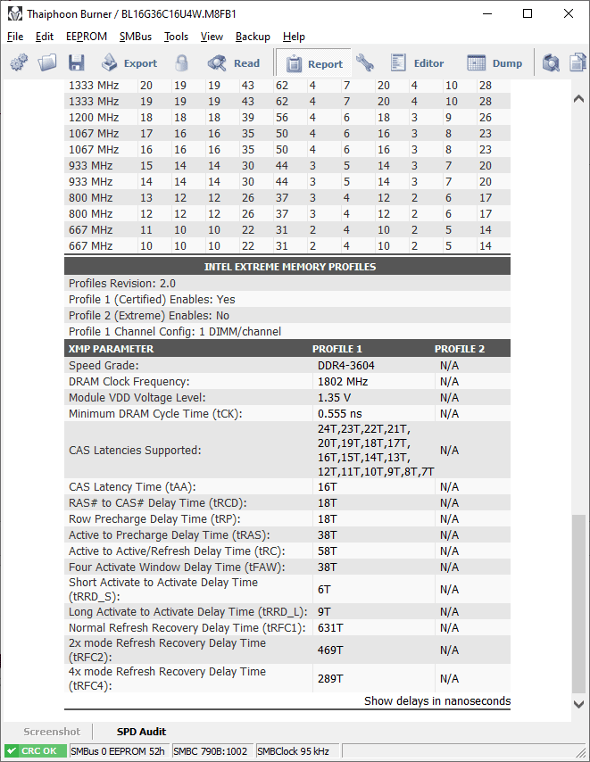

Ich habe versucht die ICs nach der Liste auf der ersten Seite zu bestimmen. Aber meine Module haben eine Bezeichnung die gar nicht erwähnt wird: 14AJ3
Hat jemand von euch eine Ahnung um was für ICs es sich bei 14A handeln könnte? Zumindest ist ersichtlich das Patriot bei den neuen Modulen jetzt auch auf 16 Gbit umgestellt hat.
Ist eine gute Frage. Nanya habe ich bisher unter 0E und Spectec unter 0J gesehen. Eventuell haben die am Code auch etwas geändert. Hast du die Möglichkeit diese mit Thaiphoon Burner auszulesen?
