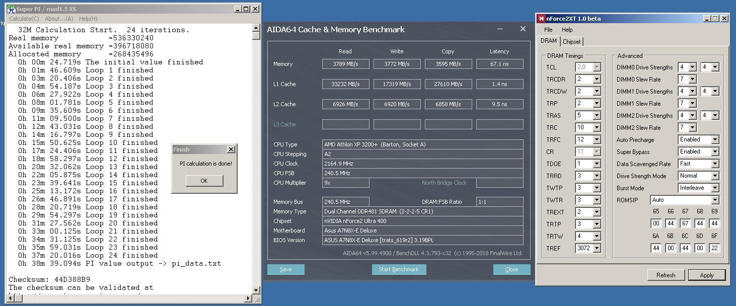

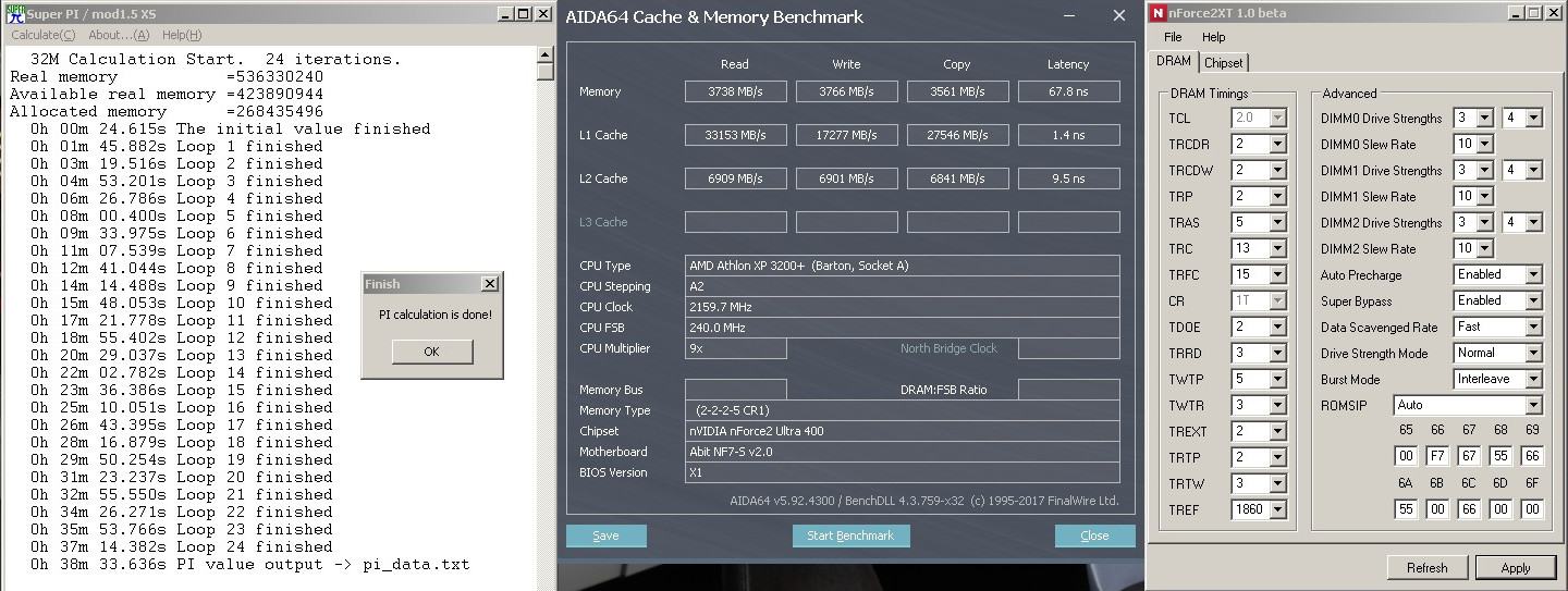

Some more results from my side. Most of the bioses seem to be in 38m 33s range, with ED-based dropping around 6 seconds.
My X1 bios which seems very similar to one of the trats bioses I tried

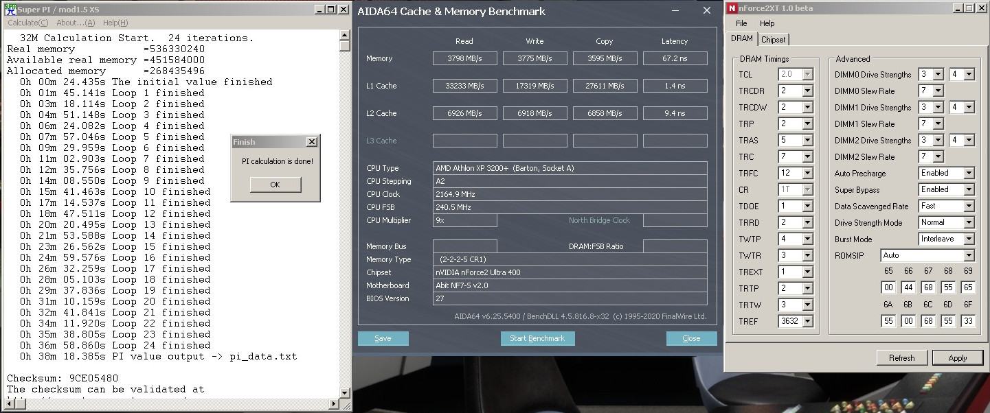

ED bios from @digitalbath

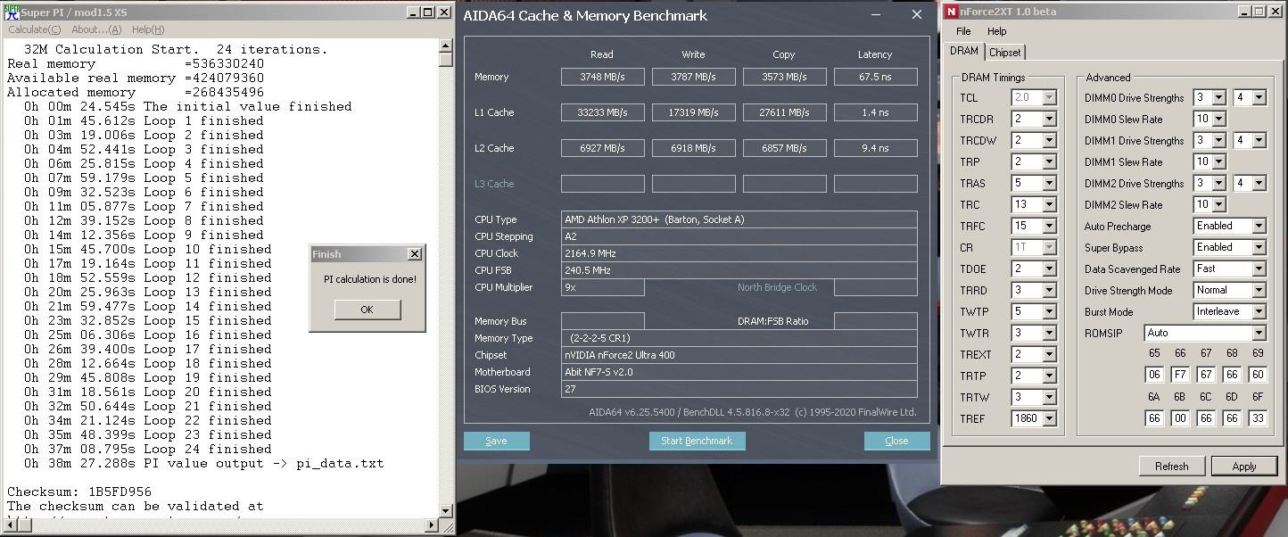

Same ED bios from above, but with the current best register values I'm using (I may have better ones soon)

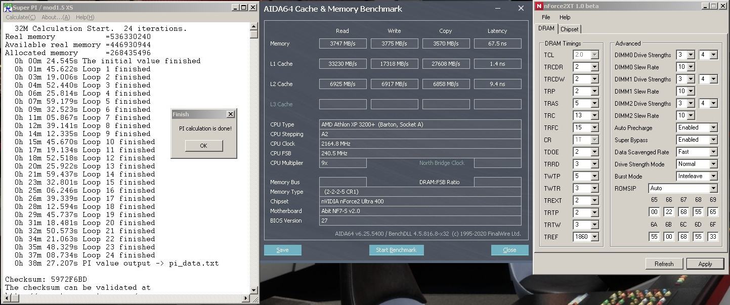

Same as above with tighter timings
ED bios required higher VDD, until I changed the ROMSIP registers (3rd and 4th image). Not sure which value helps most though.
Even if two bioses have similar/same values for the exposed registers, there might be a big difference in performance, so some of the other values in the ROMSIP tables give a big boost.
We have to find which ones...
PS: I could not POST at 8.5x260 with the bios from @digitalbath, while 8x260 worked.

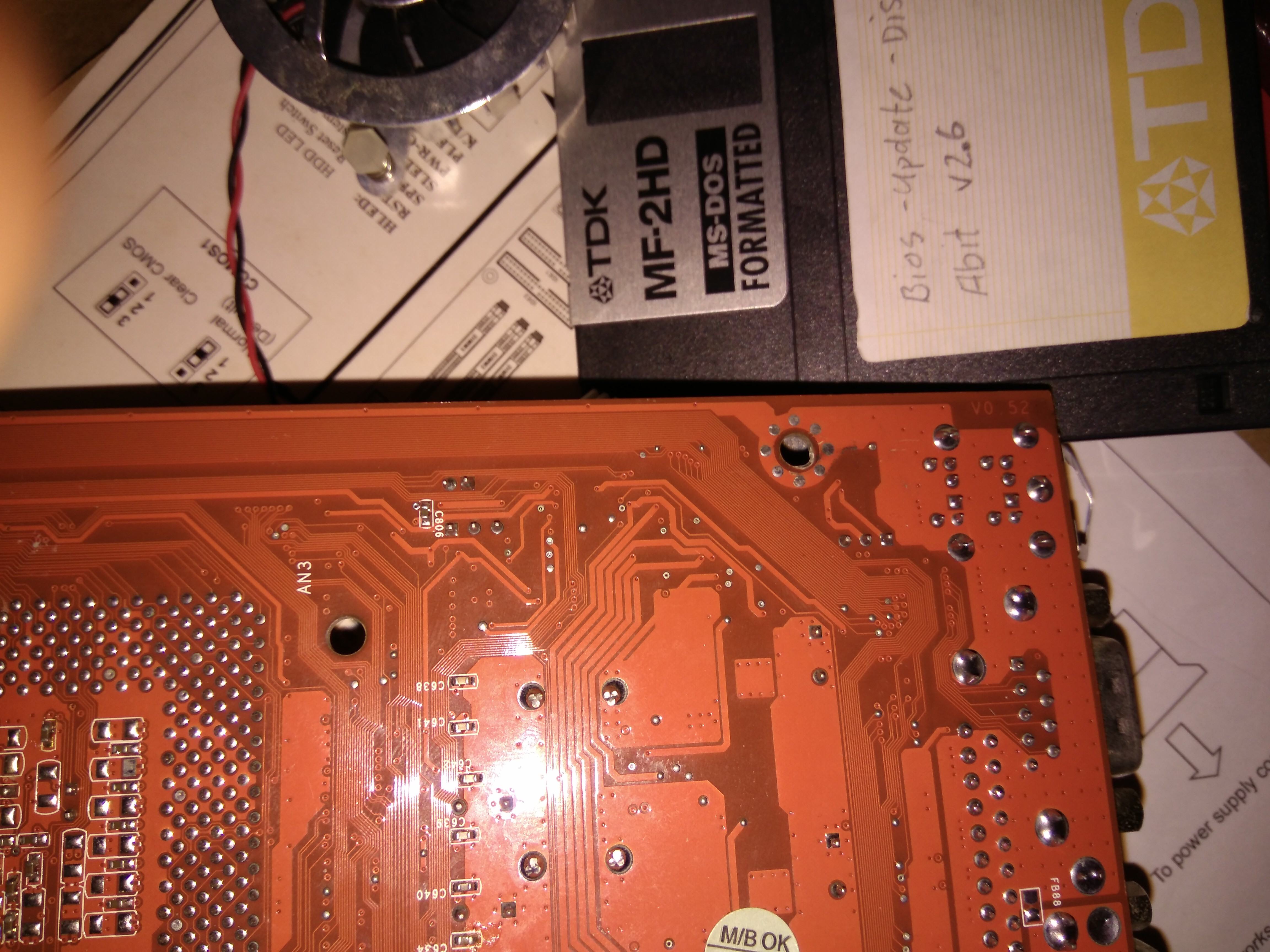

Found my PCB revisions. It's on the backside of the PCB, where the PS2 connectors for keyboard and mouse are soldered. My 250FSB Board got V0.52 and my "crap" board got V0.51.
Picture of the NF7 backside with Revision marked on the top right corner (IO panel). The cpu socket and chipset is also visible to make locating the revision a bit easier for you.
Yes, i also noticed that the exposed romsip registers seem to have a huge effect on stability and bandwidth. Testing was very easy with digitalbaths romsip settings in bios. Now that you made the new tweaker, we can probably test different registern on windows and check stability and 32M. Maybe we can find an even better (like more stable and faster) setting.

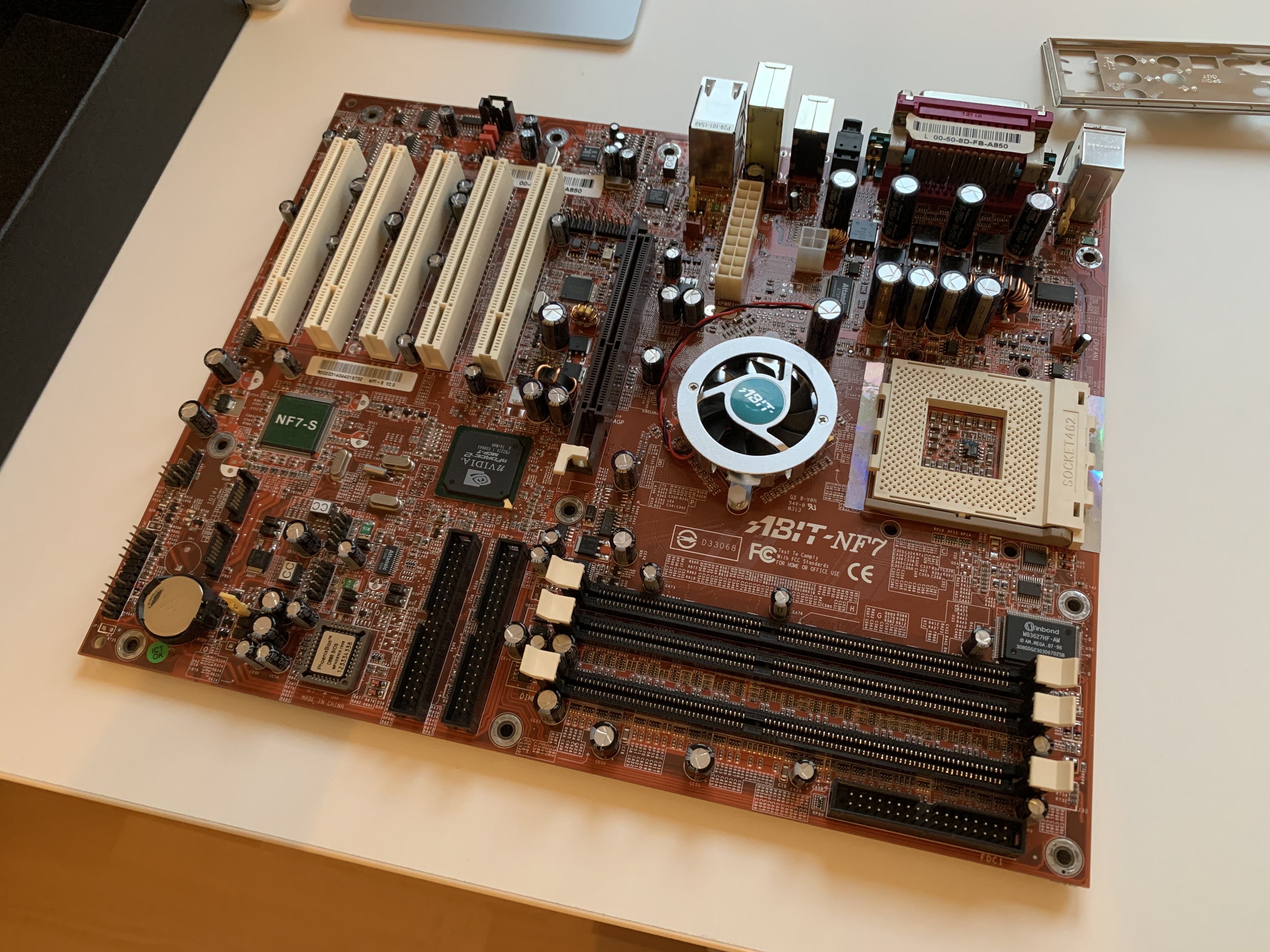

My v0.51 got black slots (northbridge week 0309 and southbridge rev A3) and my v0.52 got colored dimm slots and chipset week 0404, sb rev. A4. So i guess that v0.53 is even newer (maybe week 10 to 30 2004)?
@ItsFun
Ich rate bei deinem auch v0.51. Ist ähnlich alt wie mein 0309er.
