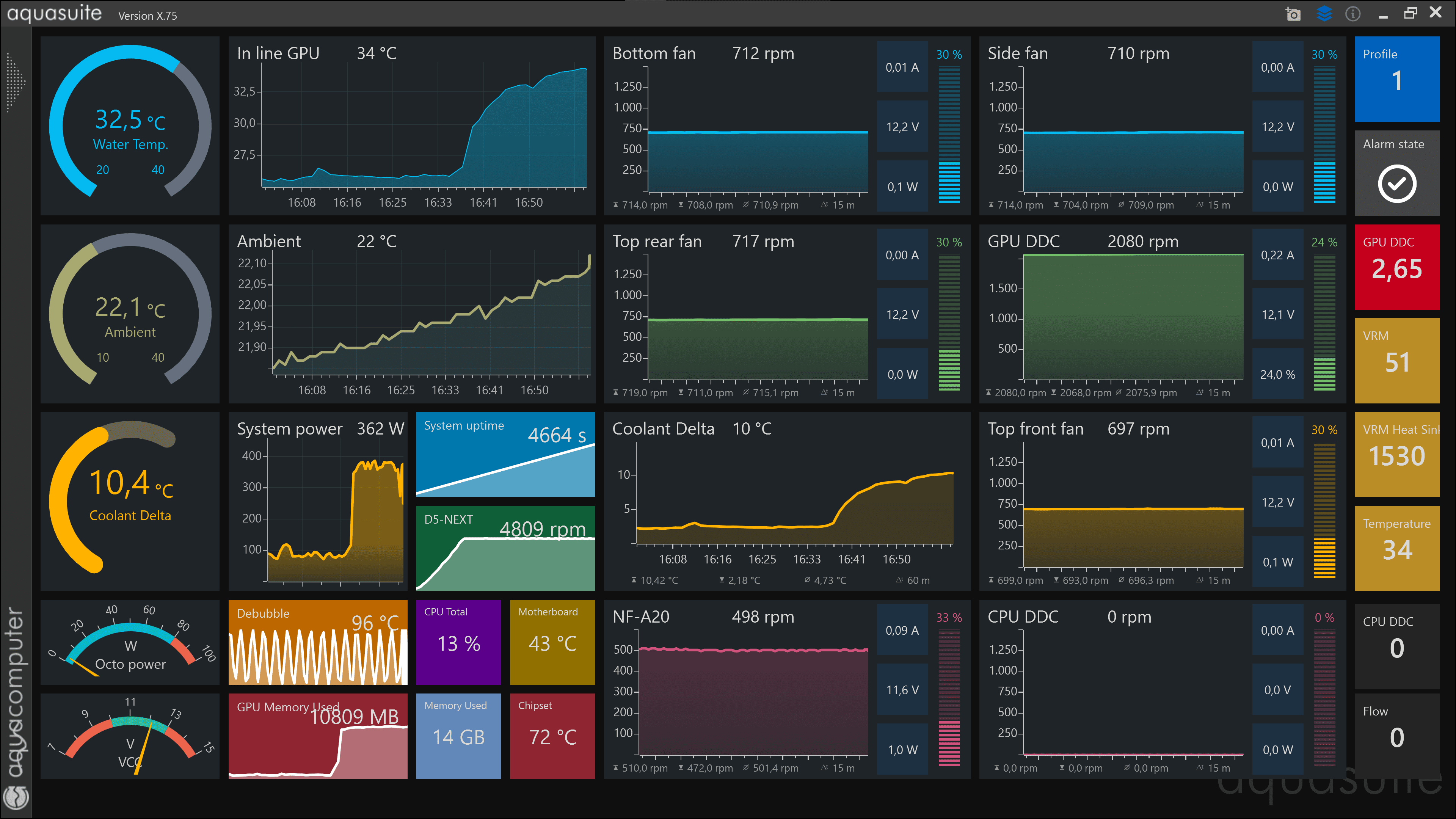

I had adjusted the sensors to be equal to eachother and have now removed that offset so that they show their original values. what do you think about these temps?
As you can see in the top left corner the temp difference between the D5 Next and the inline gpu temp sensor remains 1,5c under load. With your explanation in mind I take it this is expected?
The difference should increase under load, if your flow remains the same. I see the speed of the D5 next increasing, so does the flow. The comparison is useful if your flow remains the same, so for same rotation of the pump. For an internal delta this low your flow must be quite high, around 200l/h.
Problem is, I can't know how your pumpspeed increases exactly and how much power the system uses at idle for calculating any useful data. But I can assure you there isn't a problem. An internal delta this low is good enough to be sure you have more than enough flow. Sure, more is better, but you pay much to get few.
