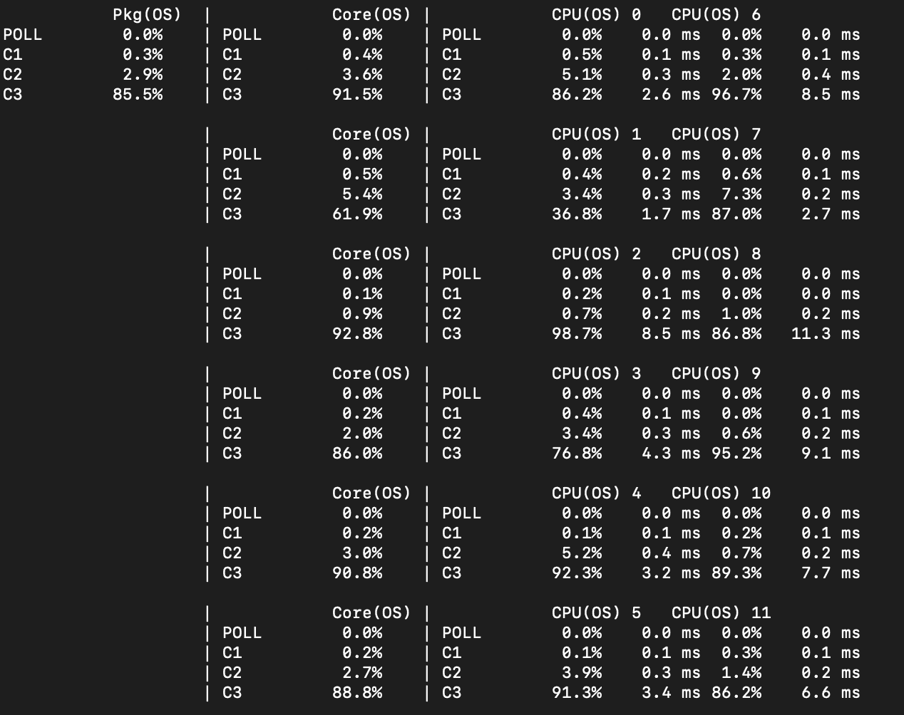

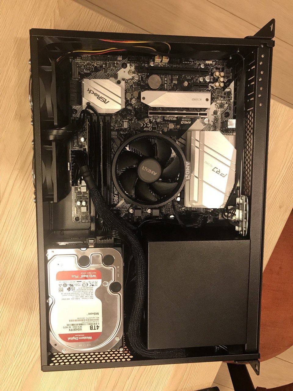

Hi everyone,
Apologies for my English, as my German is still quite basic.
I'd like to thank the community for helping me with my low-power consumption server (the Google spreadsheet is fantastic!).
My configuration/setup:
CPU: AMD Ryzen 5 PRO 4650G
CPU FAN: AMD stock cooler
Motherboard: AsRock B550M Pro4
RAM: 2x 16Gb MICRON MTA9ASF2G72AZ-3G2R x2
M2: 1x Kingston NV2 500 GB
HDD: 2x WD Red Plus 4TB (WD40EFPX)
PSU: Be Quiet! System Power 10 550W
Case fans: 2x small coolers (it don't know the brand)
Measuring device: unknown ( see attachment) 27.1W
OS: Debian (Proxmox)
Hosting: Jellyfin, Samba based NAS(ecc + zfs), Pihole, Unbound, Nginx as reverse proxy and Transmission. (LXC containers).
Configured: governor "powersafe", powertop --autotune (C3), no spun-down for HDDs, BIOS c-states and turned off other devices in the bios.
Thank you very much again :)
