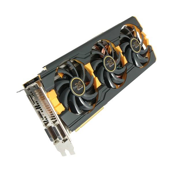

SAPPHIRE Technology has just announced two new models of its top of the range R9 290 and R9 290X graphics cards. Both models feature the SAPPHIRE exclusive Tri-X triple fan cooler, enhanced clocks and dual BIOS.
The SAPPHIRE R9 290X Tri-X features the latest GCN (graphics core next) architecture from AMD with 2816 stream processing units and an enhanced engine clock of up to 1040Mhz. It is equipped with 4GB of the latest high performance GDDR5 memory on a 512-bit interface and now clocked at 1300 MHz (5.2GHz effective) delivering higher bandwidth than the reference design. The SAPPHIRE R9 290 Tri-X has 2560 stream processing units and an engine clock of up to 1000 Mhz. It is also equipped with 4GB of the latest high performance GDDR5 memory on a 512-bit interface and clocked at 1300 MHz (5.2GHz effective).
