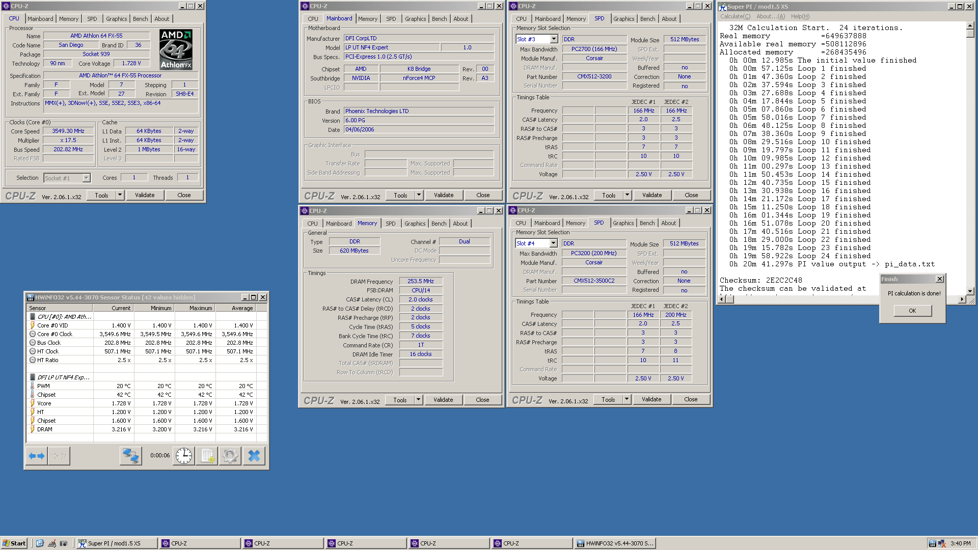

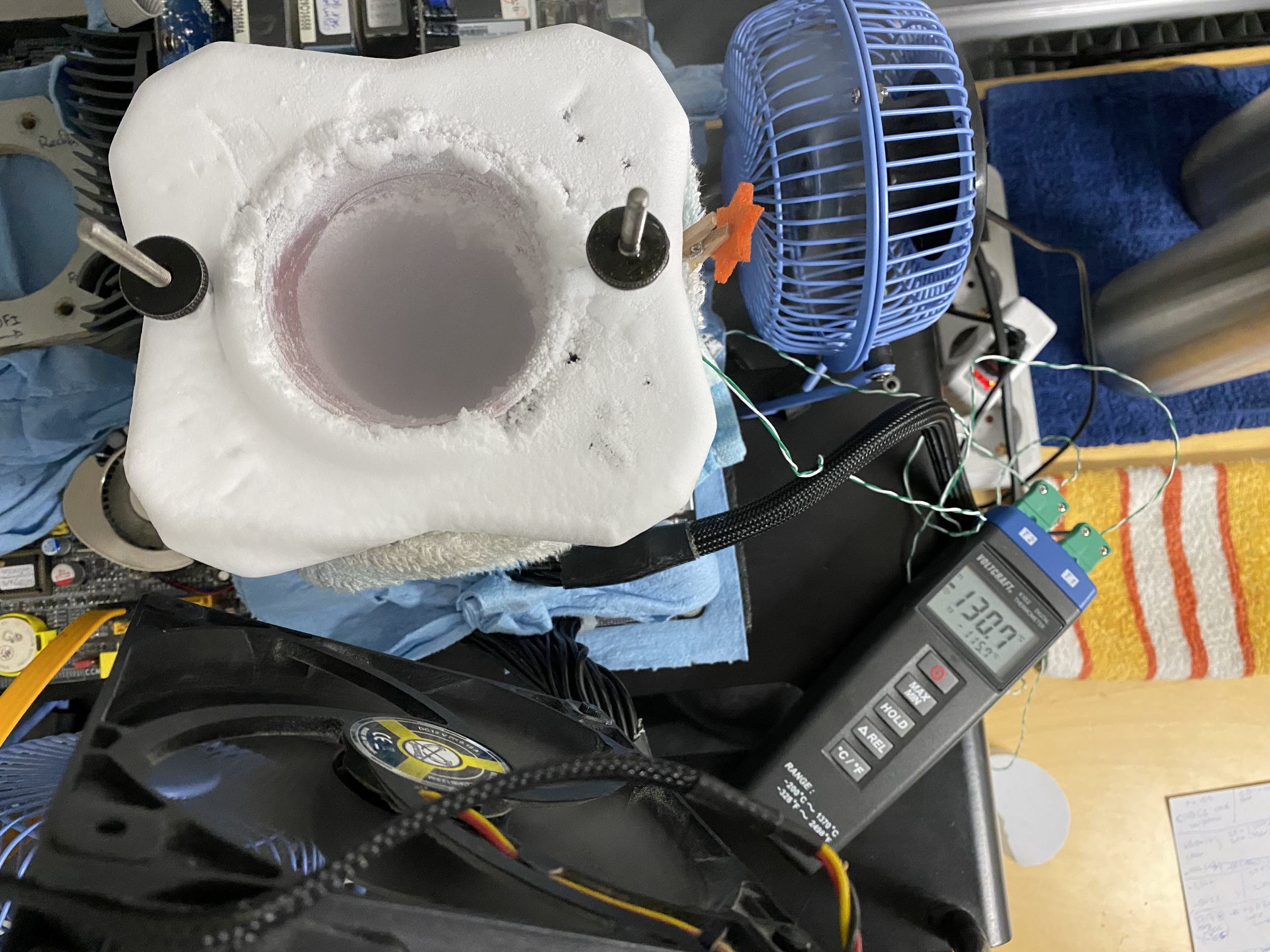

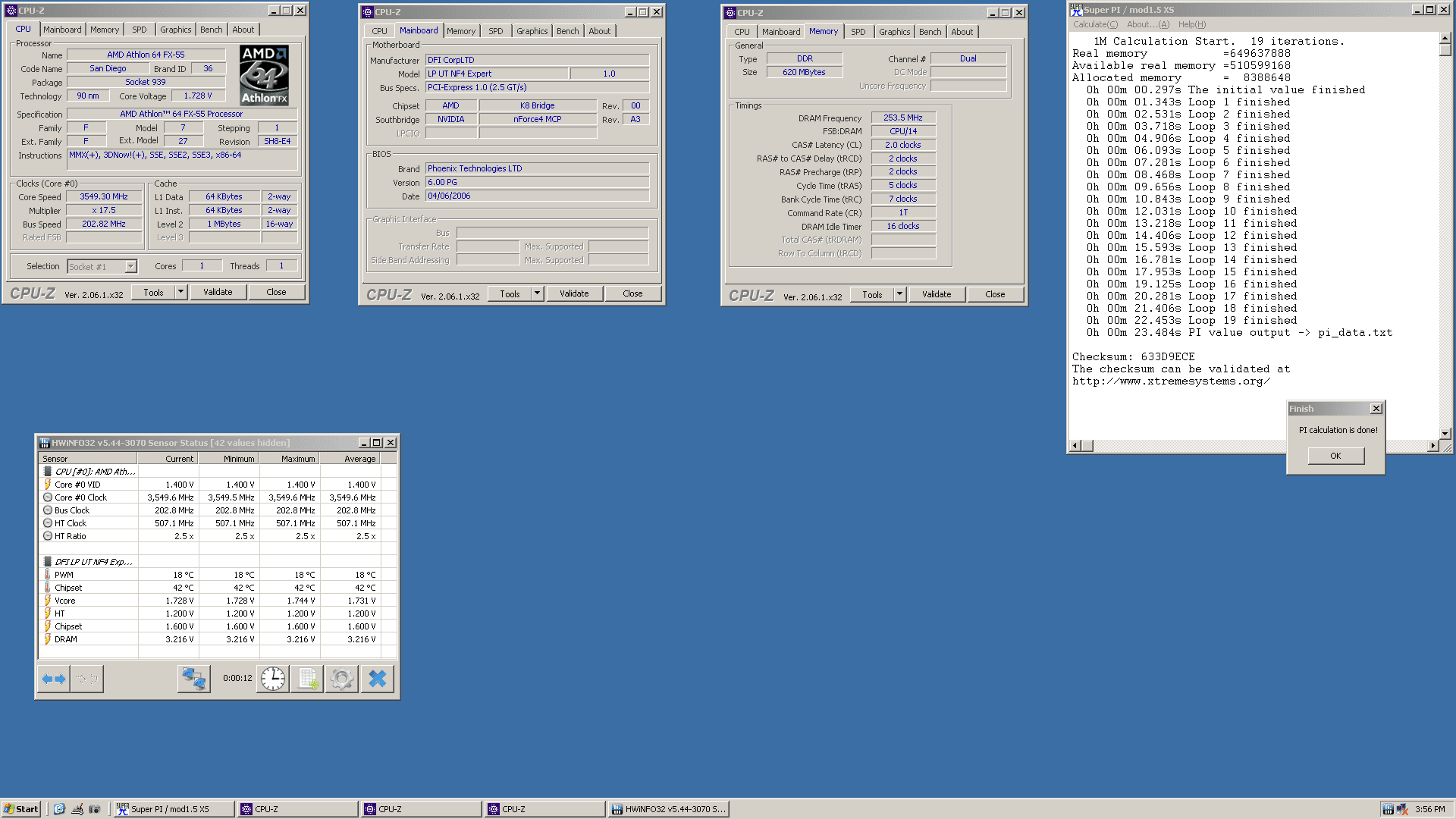

So I did a double session today. I quick benched 2 FX-55 San Diego CPU's.
Both CPU's could still boot 2400MHz at -130C (no MHz scaling beyond -95C):

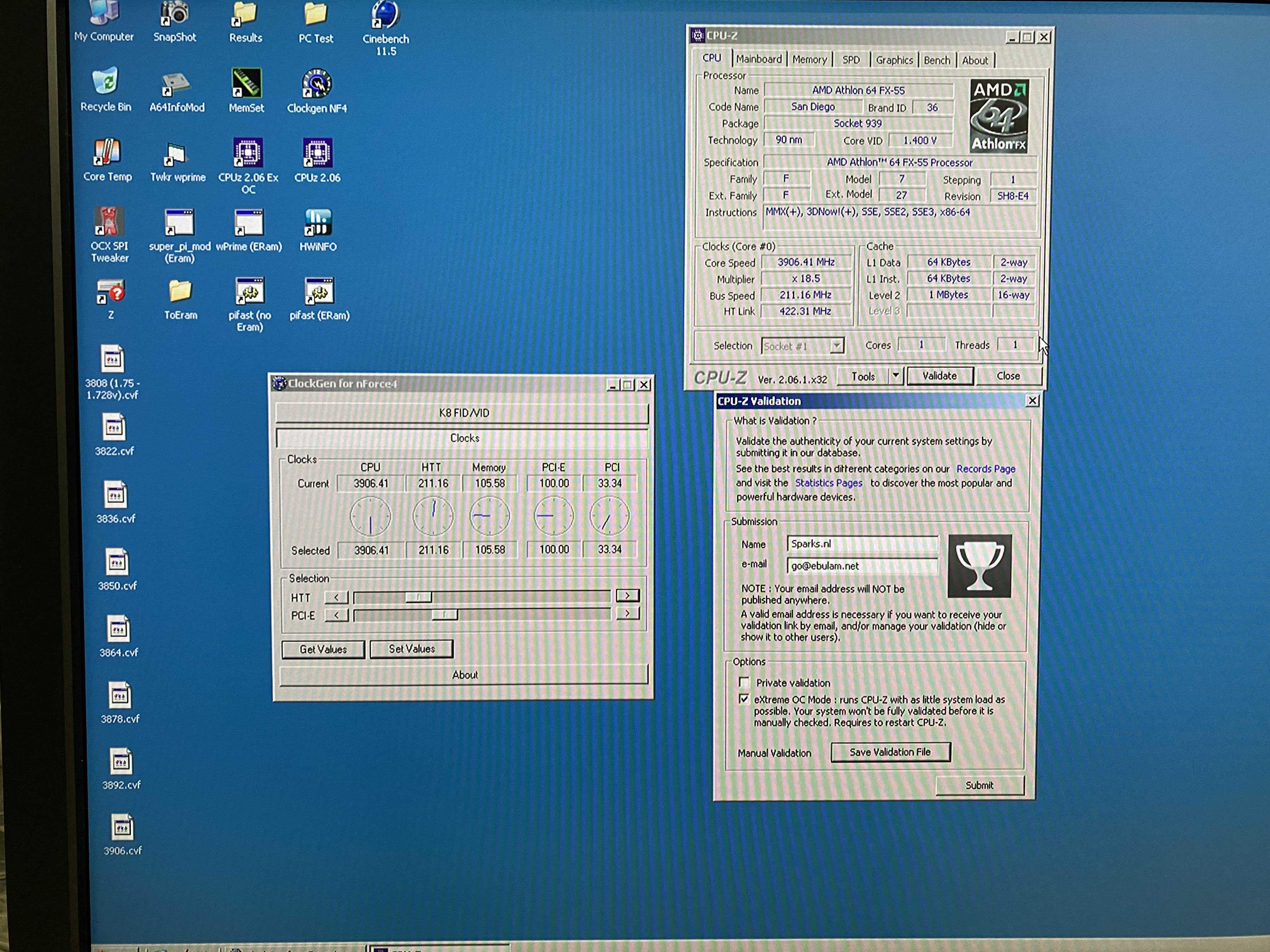

FX-55 0516 WPMW
Max validation: 3906MHz
This CPU could still improve as I did not get the change to find best temp and voltage for that temp. It got worse results after 2 hours so I decided to go on with my 2nd session.

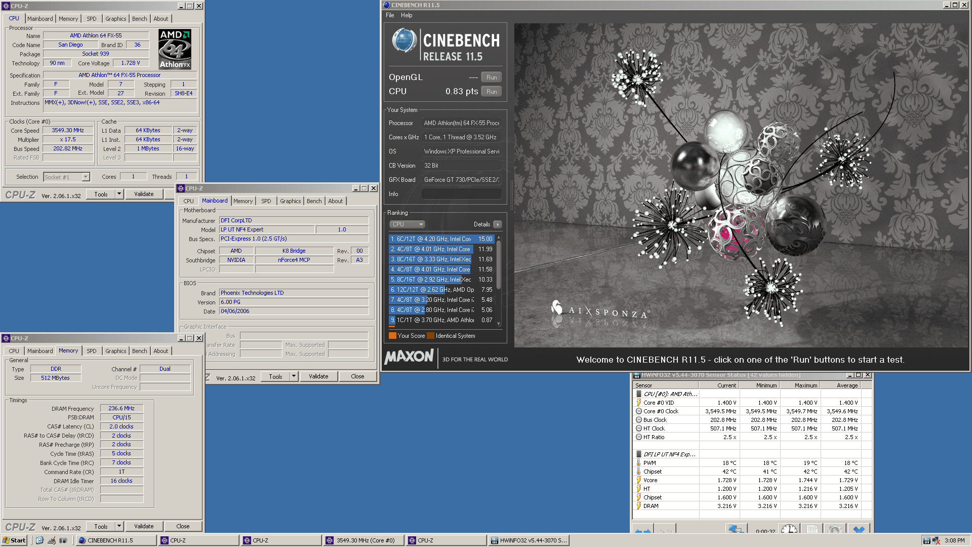

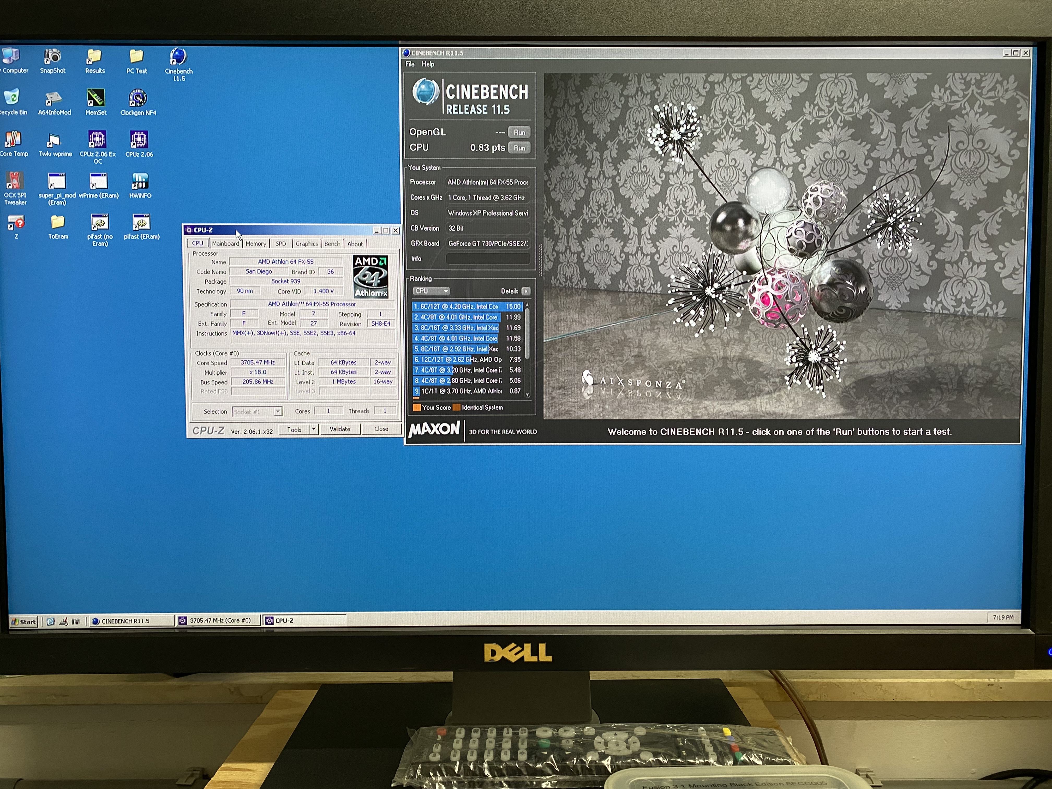

Cinebench test run on Win XP 32b and 100MHz C2:
It crashed with opening CPUz.
