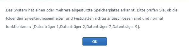

Wie dem auch sei, bekomme ich jetzt immer folgende Meldung, obwohl die Festplatten letztendlich funktionieren und auch im DS erkannt werden.
Ideen?
" found something out. after i've edited the synoinfo.conf, deleted/commented out the supportraidgroup and added SHR again, the error reappeared. So it has something to do with SHR.
Raid Group is still being shown in the Storage Manager, even if it's commented out. I'd upload some pictures, but it says there's no space left.
nvm, used the /etc Folder, not etc.defaults. Error is still there. SHR is working tho."
