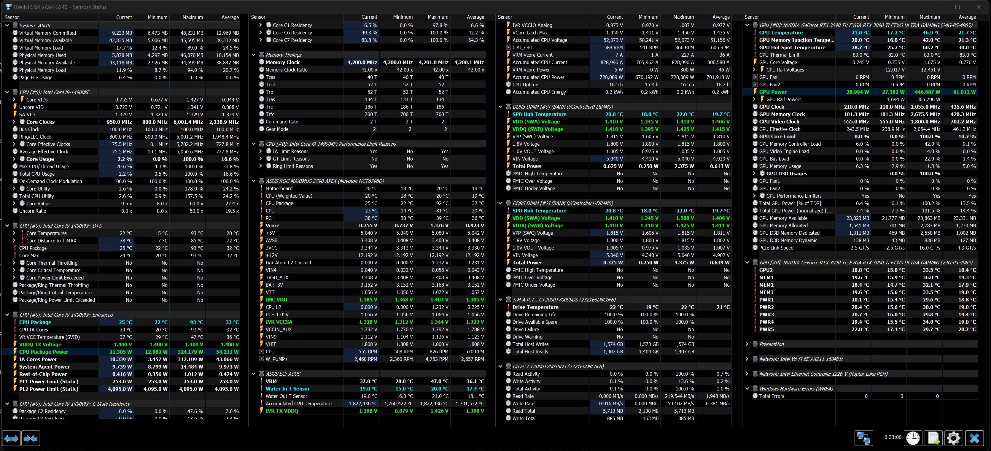

I'm hitting 324W, 93c running Y-Cruncher VT3 benches,..
