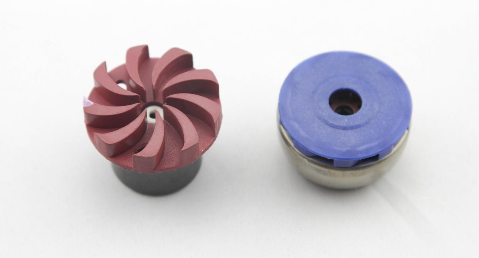

There is a difference in the rotor of the Swiftech MCP50X:

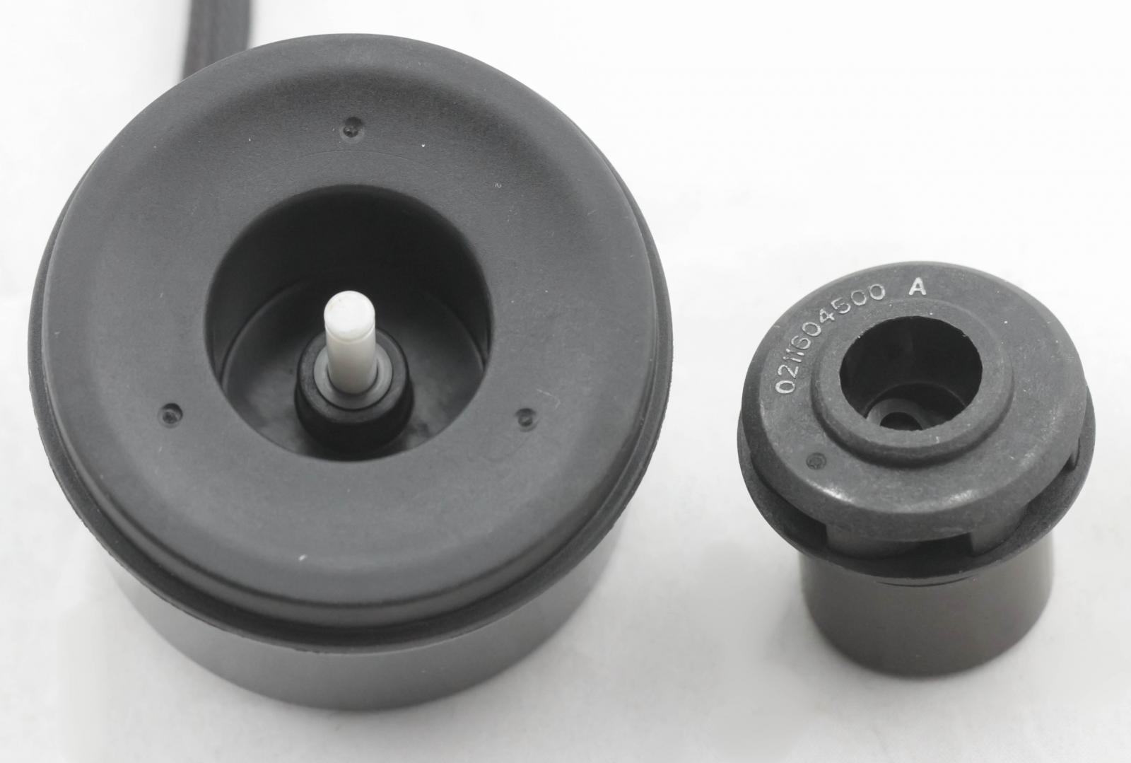

compared here with that of a Laing DDC:

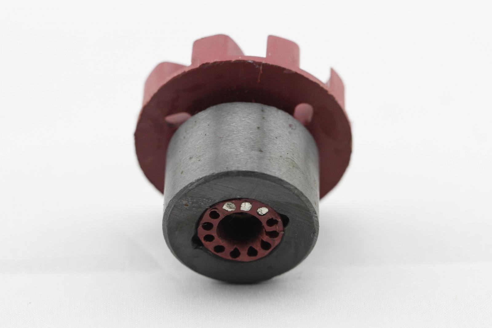

and Alphacool VPP755:
compared here with that of a Laing D5:
As you can see, the Swiftech MCP50X rotor is open- easier and less expensive to make, and has a small performance deficit compared to closer rotors of the same design. This is one of the reasons that pump is less expensive.
My tests of the VPP755 are done too, just waiting for release and pricing information. To be honest I would go with the VPP755 over the Swiftech MCP50X overall, provided longevity is not an issue. Similarly, I would go with this over a DDC as well and also a D5 in general as long as you are aware of the top compatibility issues and the "PWM" control. The knob control is also not the best as there is a fluctuation in pump RPM even after the knob is in a fixed position so during bleeding of air this can be annoying.
